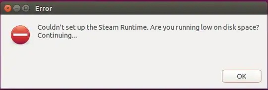

I tried installing Steam on a new installation of Ubuntu alongside Windows 7. I forgot to adjust the size of the partition after the installation so I had a pretty low amount of disk space. In the middle of installing steam I got an error message that looks like this: enter image description here
So then I took the time to adjust the disk space.
After that I tried to launch Steam again to try to finish the install. Once opened I got the same error almost instantly.

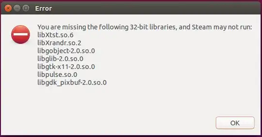

After clicking Okay I got this message: enter image description here
So now I have even more problems. I did some looking around and tried to fix that problem with solutions that other people with previous versions of Ubuntu but I did not solve that problem.

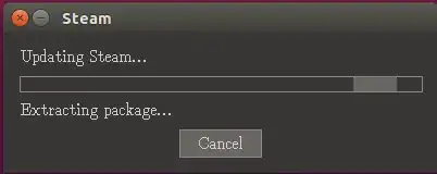

When I click okay on that error, Steam starts to load like this: enter image description here
However after about 10 seconds it stops and I get the first error and it starts this loop over again.

Error: Couldn't set up the Steam Runtime. Are you running low on disk space?

Error: You are missing the following 32-bit libraries, and Steam may not run:
libXtst.so.6
libXrandr.so.2
libgobject-2.0.so.0
libglib-2.0.so.0
libgtk-x11-2.0.so.0
libpulse.so.0
libgdk_pixbuf-2.0.so.0

Your steam-runtime.tar.xz file is damaged or corrupt.
Try running this command to delete it:
rm ~/.steam/ubuntu12_32/steam-runtime.tar.xz*
then run
steam --reset
