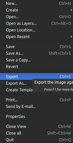

  • With GIMP, open the SVG, then use the Export action from the File menu (or press CtrlE):
    IMG:

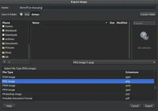

  • Select PNG from the drop down menu or the Select File Type list:

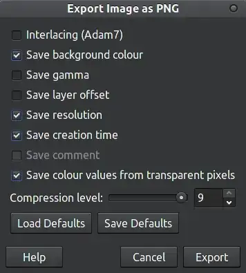

  • Select appropriate settings and export:
