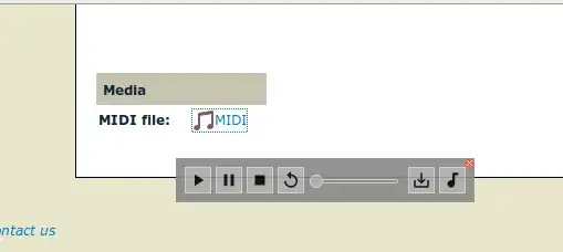

This Firefox addon is fine answer to the problem in september 2019. after adding on and click midi link the midi player open right up.
https://addons.mozilla.org/en-US/firefox/addon/midi-player/
midi player add on for firefox
