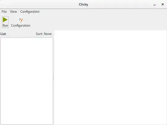

HardRock
  • 123
The installation works as expected but first you have to install click.
  1. Install checkinstall
    sudo apt-get install checkinstall
    Why? Read this.
  2. Download the current release click-2.0.1
    wget http://www.read.cs.ucla.edu/click/click-2.0.1.tar.gz
  3. Extract
    mkdir -p ~/src
    tar xf click-2.0.1.tar.gz -C ~/src
  4. Configure and install click, make isn't necessary
    cd ~/src/click-2.0.1
    ./configure
    sudo checkinstall
  5. Check click
    % apt-cache policy click
    click:
      Installed: 2.0.1-1
      Candidate: 2.0.1-1
      Version table:
     *** 2.0.1-1 0
            100 /var/lib/dpkg/status
         0.4.39.1+15.10.20150702-0ubuntu2 0
            500 http://archive.ubuntu.com/ubuntu/ wily/main amd64 Packages
  6. Configure and install clicky and here also, no make necessary
    cd ~/src/click-2.0.1/apps/clicky
    autoreconf -i
    ./configure
    sudo checkinstall
    You have to change the version number after run checkinstall
  7. Check clicky
    % apt-cache policy clicky
    clicky:
      Installed: 0.1-1
      Candidate: 0.1-1
      Version table:
     *** 0.1-1 0
  8. Run clicky
A.B.
