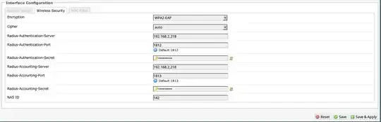

Now my router uses radius. enter image description here
