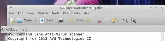

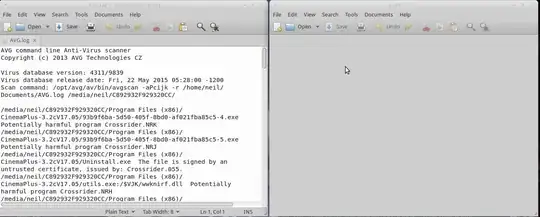

Yes you can
  1. open your file with gedit
  2. click the file name in the gedit tab so and drag it out like so.
This will create a new gedit window

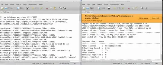

now open the same file in the other gedit window
Then click Edit Anyway

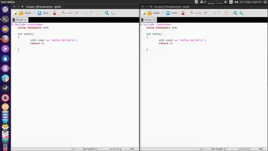

In case anybody still wonders, at least in Ubuntu 16.04 there is a workaround using also tabs as requested by the OP and with a read-only side (just replied here):
  1. Open the file in a first window.
  2. Go to Documents->New Tab Group (or press Ctrl+Alt+N). This will vertically split the window opening a new document as a tab on the right side.
  3. Open a second window and open again the same file (as suggested by @terdon: gedit --new-window file). It will tell you that the file is opened somewhere else and ask you if you want to edit the file anyway. My suggestion is to use "Don't Edit", otherwise you'll be overwriting your own changes from one window to the other. It's better to use one for writing an the other for reading/copying.
  4. The tricky points: Open a new tab in the second window, so now you can see tabs instead of only the document.
  5. The tricky points: Drag from the second window, the tab of your document and drop it as a tab in the right side of the original window.
  6. Now you can close the second window and remove the undesired tabs of the right side of the original window.
