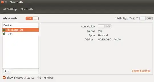

I am not able to connect to any Bluetooth device.
The below "Connection" switch is greyed out for any kind of Bluetooth device. All of them work in connection with my Android device (i.e. the devices are not broken).

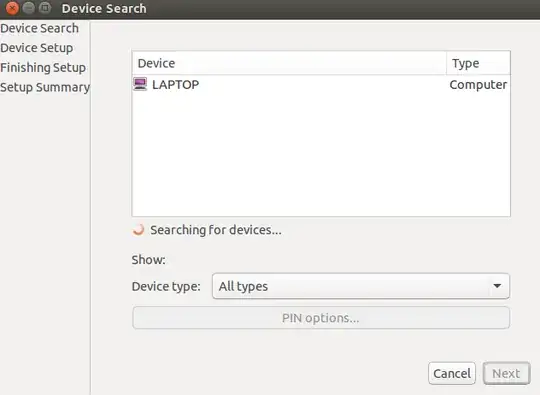

I can search for new bluetooth devices. Therefore, I don't think that it's a firmware-related issue.

I could solve the problem by re-pairing the devices.
