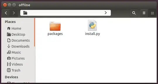

  • Your directory structure should look like this
install.py
