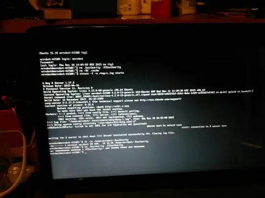

After a failed installation cuda, I entered the password correctly, but this does not lead to anything. What should I do?
Console screenshot:
Reset ubuntu :)
Console screenshot:
Reset ubuntu :)
You could try this, and push (alt+Ctrl+f6), and type in yours users name and password, and then type this in the tty:
dconf reset /etc/compiz
unity --replace --reset-icon & disown
and it might work.
