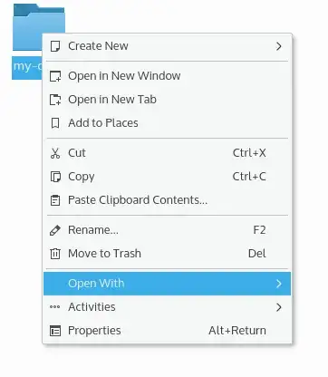

Ark is installed but there is no option to create an archive in the file manager's context menu.
There is a /usr/share/kservices5/ServiceMenus/ark_servicemenu.desktop.

I was missing 'extract' and 'compress' in Dolphin under Ubuntu 16.04 (not Kubuntu!) and fixed it by installing Ark:
sudo apt-get install ark

There are KDE4 applications and there are new KF5 applications.The KDE4 parts are looking the service menus from:
~/.kde/share/kde4/services/ServiceMenus/ and /usr/share/kde4/services/ServiceMenus/
The new KF5 service menus are at:
~/.local/share/kservices5/ServiceMenus/ and /usr/share/kservices5/ServiceMenus/*
But the solution for 15.10 (here and here) is different from the one for 15.04.
I used the second solution for 15.10, running this command:
sudo ln /usr/share/kde4/servicetypes/konqpopupmenuplugin.desktop /usr/share/kservicetypes5/konqpopupmenuplugin.desktop
