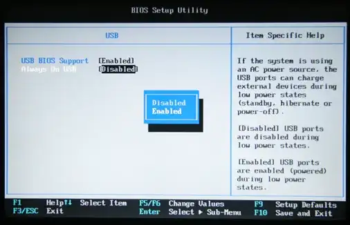

Easy:
  1. Turn on the laptop
  2. Go to the BIOS settings (no need to fully boot the computer)
  3. Make sure charging external devices during low power states is enabled (if the option is present)
    BIOS Screen
  4. Plug in the phone
  5. Shut down the computer.
Now the phone will charge off the laptop's battery again!
