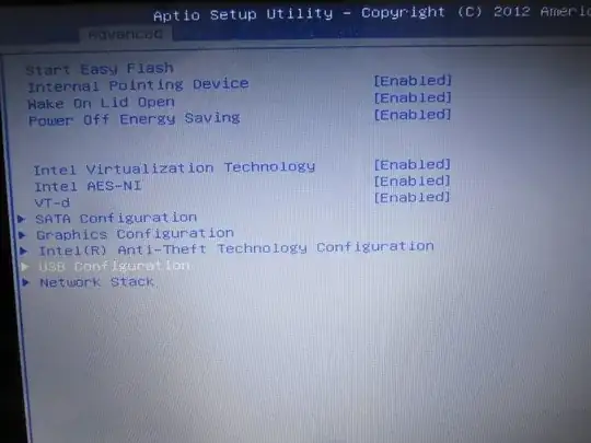

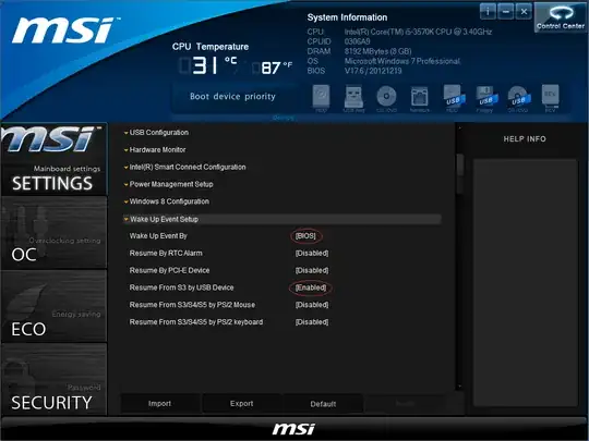

Bios screenshots :
mxdsp
  • 3,988
Try the wakeup events like in this post into your BIOS! enter image description here
