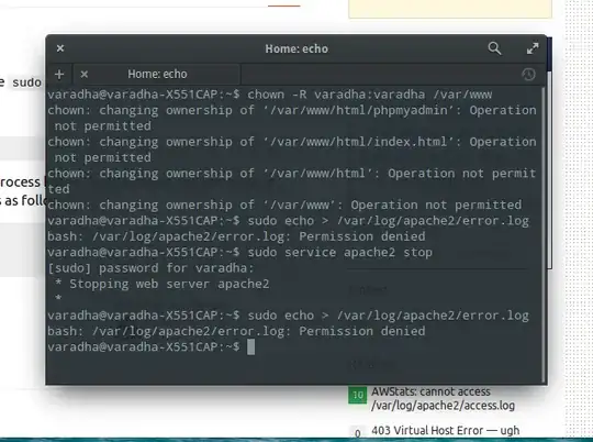

I am new to Ubuntu. I can find my error log here in var/log/apache2/error.log. but i couldn't clear it. i tried to change the permission to edit the content. But couldn't achieve it.
Please help me to remove it. I have read some question previously asked. but it does-not help me .

Here is my terminal screen-shot:

Most files in /var/log are owned by root.
So, if you want to modify them, you will have to use sudo.
To clear the error file, give command:
sudo bash -c 'echo > /var/log/apache2/error.log'
If that doesn't work, then very likely the apache process keeps the file locked and you have to stop apache before you can clear the file. This goes as follows:
sudo service apache2 stop
sudo service apache2 start
Note: You can't use sudo echo > /var/log/apache2/error.log here, because sudo executes the echo command but the redirect to error.log is done under the process of the user, which doesn't have elevated privileges. That's why I pass the whole command to bash, which is then executed by sudo.
