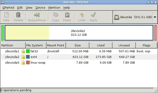

It looks like this now. I only have Ubuntu, so I don't have dualboot of any kind.
I was thinking about creating a new partition from the unused space in /dev/sda2 for my backup stuff and then create another partition to install a bootable Ubuntu on, then I'll boot into that bootable partition and then format and install Ubuntu on /dev/sda2 again.
Is it possible for me to achieve something like this?

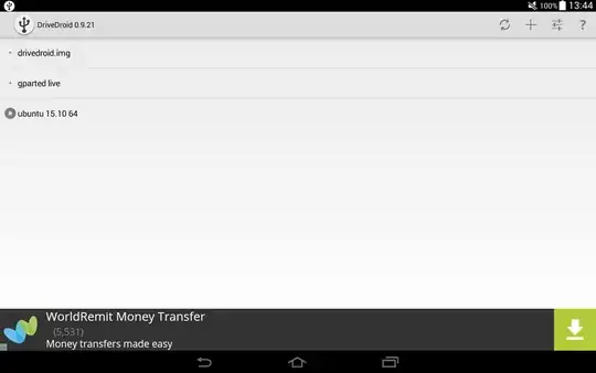

I found a way which requires an rooted Android device.
You need to download this app: DriveDroid - Google Play. And move a Ubuntu iso file to your Android device and use the app to make Android bootable with that iso and then use your computer to boot from it.
I had issues with I couldn't do anything with my /dev/sda2 partition even when booting from Android. So I downloaded GParted live iso and used GParted to shrinken my root partition and make a backup partition, then I used Ubuntu to move my files from my root partition to the new backup partition.
Then set Android to be a Ubuntu bootable again and install ubuntu from there. Then copy my files and used gparted again to make my new ubuntu use the old backup partition.
