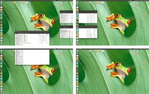

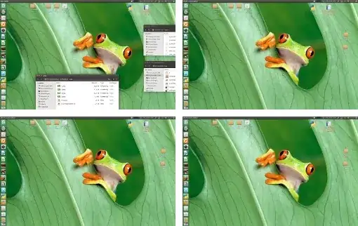

I believe the solution below is doing what you describe. This is what it does:
The usual effect: overlapping windows will appear on the adjacent workspaces
Effectively, when pressing a key combination, this will be the result
In practice:
An example
  • Working on (e.g.) workspace 1, with some windows overlapping on other workspaces
  • Then move to workspace 2, press the shortcut key combination: all windows, except the ones on the current workspace, will be minimized, and thus not appear on the current workspace anyway (except for the launcher).
  • Then returning to workspace 1, pressing the key combination again, the desktop will be exactly like you left it. Even de window order (z-wise) and possibly minimized windows will be exactly like it was. At the same time, windows on other than the current workspace will be hidden.
