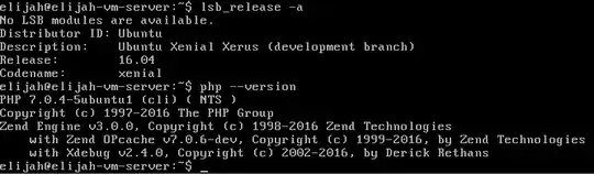

PHP 7.0 is currently available in Ubuntu 16.04 LTS BETA. I run it myself and it works.
Additionally, PHP 7 appears as package "php" and php5 as "php5".
