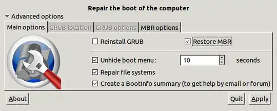

You could use boot-repair to restore your MBR. Follow the steps below:
You need to have Ubuntu Live CD or Live USB. Normal session can be used to repair the grub. Boot using your Ubuntu Live CD or Live USB, while booting choose Try Ubuntu.
Once booted then open a terminal, and run the following command one by one to install the boot repair.
  • Add boot-repair to the repository
    sudo add-apt-repository ppa:yannubuntu/boot-repair
  • Update your repository
    sudo apt-get update
  • Install boot-repair
    sudo apt-get install -y boot-repair
Once Installation complete run boot-repair on terminal by typing the following command or select it by System->Aministration->Boot Repair.
boot-repair
It will scan the System for few seconds and will pop-up a small window. Select Advanced options and in Main options tab select Restore MBR.
Then select the MBR options tab, check the drive for MBR and Ubuntu. By default all the options are selected correctly if not select the drive where your MBR is to be and the correct OS.
Once done click ok and restart your system.
