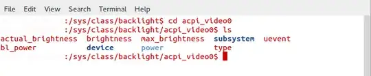

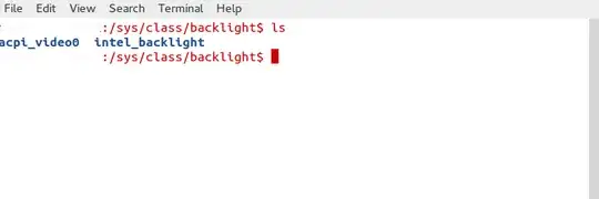

Everything in Linux is a file. There is a device file to change the brightness.
Open terminal using Ctrl+Alt+T.
Execute this command: cd /sys/class/backlight/ . Under this directory you'll find a dir named acpi_video0, you might get it with different name.
CD to that directory. cd acpi_video0 and open the file brightness using root user.
You can write a command or a keyboard shortcut that does the modification of the file for you. It's up to you how you want it!
