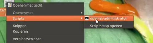

I tested the solution from here, and it works fine (running 14.04/nautilus).
To not post a link-only answer:
  1. install gksu
    sudo apt-get install gksu
  2. Navigate to ~/.local/share/nautilus/scripts
  3. Create and open an empty file, name it open-as-administrator, paste the script below:
    #!/bin/bash
    # this code will determine exactly the path and the type of object,
    # then it will decide use gedit or nautilus to open it by ROOT permission
    # Determine the path
    if [ -e -n $1 ]; then
    obj="$NAUTILUS_SCRIPT_SELECTED_FILE_PATHS"
    else
    base="`echo $NAUTILUS_SCRIPT_CURRENT_URI | cut -d'/' -f3- | sed 's/%20/ /g'`"
    obj="$base/${1##*/}"
    fi
    # Determine the type and run as ROOT
    if [ -f "$obj" ]; then
    gksu gedit "$obj"
    elif [ -d "$obj" ]; then
    gksu nautilus "$obj"
    fi
    exit 0
  4. Make the script executable
  5. Either log out and back in, or run:
    nautilus -q
AGAIN: the script is not mine! found it on http://ubuntuhandbook.org
