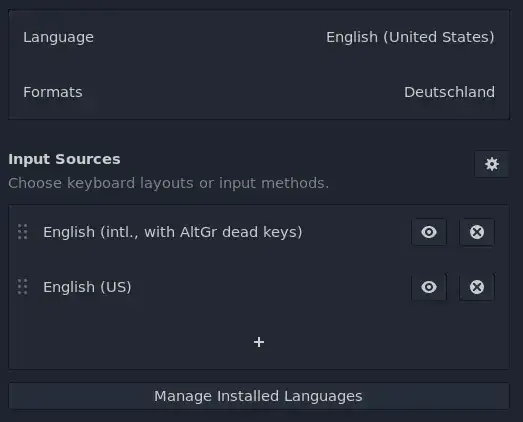

Menu Option.
English (intl., with AltGr dead keys) option

On installs of Ubuntu 14 and 16 atleast:
  1. Go to taskbar --> Find En or something like that based on the keyboard you have chosen
  2. Text Entry settings
  3. add English (international with AltGr dead keys)
