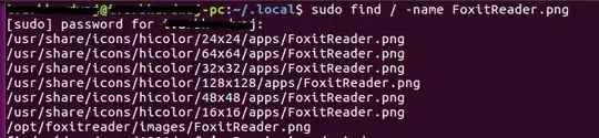

  1. Searched for FoxitReader.png using find command. "FoxitReader.png" was shown in /usr/share/local/icons/hicolor/.... Search output:
  2. Simply copied all the png image in /usr/share/local/icons/hicolor/... to ~/.local/share/icons/hicolor/...
This immediately shows icons on dashboard search. No reboot required.
