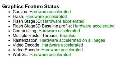

First of all, go to the url chrome://gpu.
It should look something like this: click here to show image if not displayed
If so, go to the url chrome://flags.
  1. Go to Override software rendering list and click enable.
  2. Go to Enable experimental canvas features and click enable.
Then, press CTRL + F and search for the word raster.
  1. Change Enable display list 2D canvas to Enabled.
  2. Change Enable GPU rasterization to Force Enabled for all layers.
  3. Change Enable zero-copy rasterizer to Enabled.
When you are done, click Reload and go to the URL chrome://gpu and it should look like this:
click here to see image if not displayed
Hopefully, this should make a difference.
