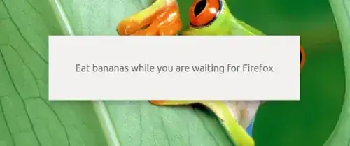

which creates a splash screen like:
Of course, you can set any background colour, font and fontsize, images etc, depending on your taste, but this is the basic idea.

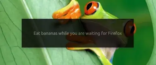

As mentioned the example above is quite straightforward. Of course you can make it much smoother, pimp the splash screen in all possible ways, or even make it semi- transparent:
(code:)
#!/usr/bin/env python3
import gi
gi.require_version('Gtk', '3.0')
from gi.repository import Gtk, Gdk, Pango
class Splash(Gtk.Window):
    def __init__(self):
        Gtk.Window.__init__(self, title="splashtitle")
        maingrid = Gtk.Grid()
        self.add(maingrid)
        maingrid.set_border_width(80)
        # set text for the spash window
        label = Gtk.Label("Eat bananas while you are waiting for Firefox")
        label.modify_font(Pango.FontDescription('Ubuntu 22'))
        maingrid.attach(label, 0, 0, 1, 1)
def splashwindow():
    window = Splash()
    window.set_decorated(False)
    window.set_resizable(False)
    window.override_background_color(Gtk.StateType.NORMAL, Gdk.RGBA(0,0,0,1))
    window.modify_fg(Gtk.StateFlags.NORMAL, Gdk.color_parse("grey"))
    window.set_opacity(0.8)
    window.set_position(Gtk.WindowPosition.CENTER)
    window.show_all()
    Gtk.main()
splashwindow()

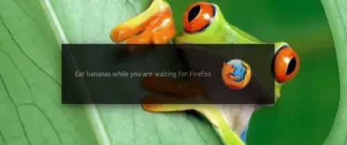

or include an image:
(code:)
import gi
    def __init__(self):
        self.add(maingrid)
        image = Gtk.Image()
        # set the path to the image below
        image.set_from_file("/path/to/image.png")
        maingrid.attach(image, 1, 0, 1, 1)
        maingrid.set_border_width(40)
        label.modify_font(Pango.FontDescription('Ubuntu 15'))
def splashwindow():
    window = Splash()
    window.show_all()
    Gtk.main()
splashwindow()
and so on...
