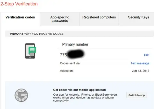

1. Enable 2-Step Verification on this page:
https://accounts.google.com/SmsAuthConfig
2-Step Verification

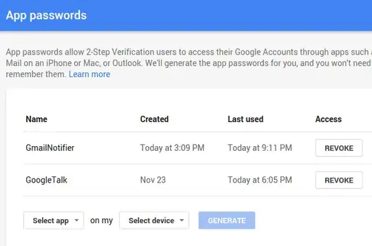

2. Generate a new App password for Pidgin on this page, select Other and name it however:
https://security.google.com/settings/security/apppasswords
App password

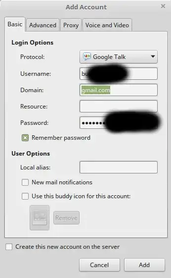

6. Right-click the system-tray icon of Pidgin and choose Accounts.
7. Add or modify your Google Talk account to have Username without @gmail.com or your own domain.
8. If you have your own domain for Google account, fill in the Domain field, otherwise there should be gmail.com present by default (without @).
9. The Resource is an XMPP specific thing that allows one to use several clients for the same account. Under normal circumstances leave blank.
10. Fill in the Password generated in step two.
11. Optional, but convenient, if on a secure computer, is ticking Remember password.
12. Local alias leave blank.
13. It should look like this:
Adding Google Talk account to Pidgin
