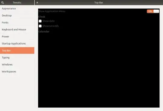

I don't find an option in gnome-tweak-tool for moving time to the middle.
