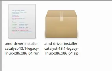

Open the folder you saved the downloaded file to and extract it contents.

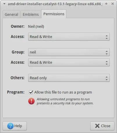

Right click on the file that was extracted and click properties, then click on the permission tab and tick "Allow this file to run as a program".
After having done this, double click the extracted file - it should ask you for your root password and then it will run you though the setup and install your display drivers.
