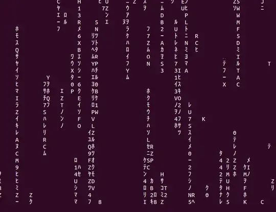

cmatrix is another great one! Install it with:
sudo apt-get install cmatrix
The manpage description on it:

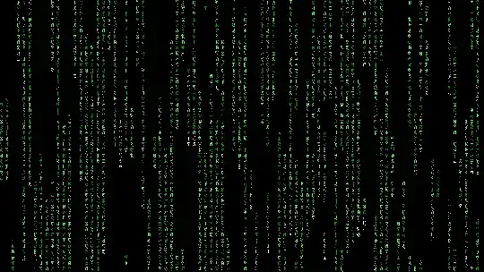

Examples:
Normal Terminal running:
cmatrix -s -b
Console:
cmatrix -s -b -l
Note: Although I do not show it in the images here, it is animated.
And if you want it to work like a proper screensaver (though the -l option won't work) then check out this answer.

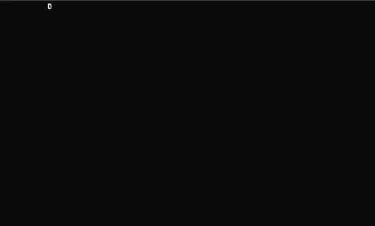

Pipes.sh
The classic screensaver in ASCII.
Usage :
wget https://raw.githubusercontent.com/pipeseroni/pipes.sh/master/pipes.sh
chmod +x pipes.sh
./pipes.sh
Installation :
git clone https://github.com/pipeseroni/pipes.sh.git
cd pipes.sh
sudo make install
Options :
 -t #
Type of pipes. Refer to the documentation to see them all.
-f [20-100]
Framerate.
-s [5-15]
Probability of a straight fitting.
-r LIMIT
Reset after x characters, 0 if no limit.
-R
Random starting point.
-B
No bold effect.
-C
No color.
Refer to the documentation for more information.

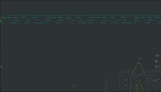

This ASCII animation can be used a screensaver:
Live aquarium
You can find out how to install it here.
The first portion of the installation will take care of any remaining dependencies that aren't included in the standard Perl installation. For this installation, follow these steps:
  1. Open up a terminal windows. If you are using a GUI-less server then just log in.
  2. Change to the /tmp directory with the command cd /tmp.
  3. Download the Terminal Animation package with the command wget http://search.cpan.org/CPAN/authors/id/K/KB/KBAUCOM/Term-Animation-2.4.tar.gz.
  4. Unpack the Terminal Animation package with the command tar -zxvf Term-Animation-2.4.tar.gz.
  5. Change into the newly created directory with the command cd Term-Animation-2.4/.
  6. Build the makefile with the command perl Makefile.PL && make && make test.
  7. Compile Terminal Animation with the command sudo make install
Now to install the actually asciiquarium application. Follow these steps.
  1. Open a terminal window (again, if you are using a GUI-less server, just log in).
  3. Download the necessary package with the command wget http://www.robobunny.com/projects/asciiquarium/asciiquarium.tar.gz.
  4. Unpack the asciiquarium package with the command tar -zxvf asciiquarium.tar.gz.
  5. Change into the newly created directory with the command cd asciiquarium.
  6. Copy the executable to the necessary directory with the command sudo cp asciiquarium /usr/local/bin.
  7. Give the executable the proper permissions with the command sudo chmod 0755 /usr/loca/bin/asciiquarium.
It is time to test out the waters of asciiquarium. To do so open up your terminal window (or if using a GUI-less machine - log in) and issue the command /usr/local/bin/asciiquarium

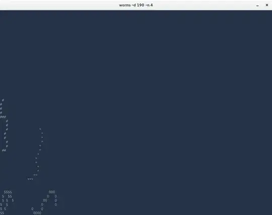

Source
sudo apt-get install bsdgames
worms -d 190 -n 4
rain -d 180

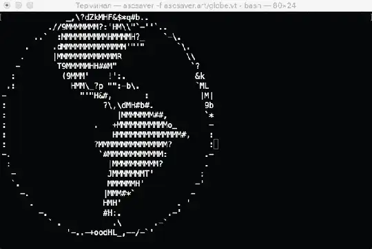

ASCII Saver – Screensaver for terminals. This is my attempt to run some animation while there is no I/O on a terminal.enter image description here
