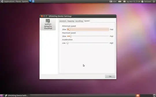

There is a GUI for this, gpointing-device-settingsInstall Gpointing device settings:
sudo apt-get install gpointing-device-settings
GPointing Device settings dialog This program has several features missed in the standard gnome-mouse-properties configuration dialog, like advanced touchpad scrolling settings. If all you need is to adjust acceleration settings, use gnome-mouse-properties instead.
