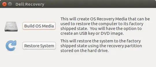

I (yesterday) bought a Dell Latitude 5480 and it came with a pre-installed Ubuntu.
During the installation and afterwards, I could create a recovery Image that could restore to the factory shipped state. See screencap below.
This isn't a "pure" solution and don't even know if it even works (whether all the drivers would be installed correctly).
