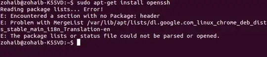

I am trying to install sshd on my Ubuntu system but I am unable to do so. I tried below things.
  1. sudo apt-get install openssh but I received below error. enter image description here

SSHD server is in openssh-server package. You need to install it this way, after fixing the problem with MergeList.
sudo apt-get install openssh-server
