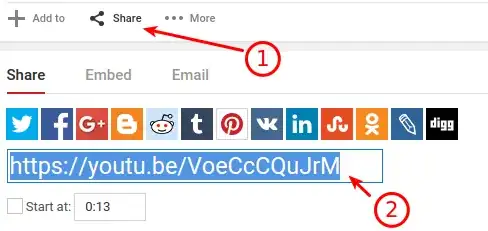

Well, I'm not sure how you got that URL in your question, but just copying the Youtube URL for the video (eg https://youtu.be/VoeCcCQuJrM) either from the URL bar or from the share box:
worked just fine for me in VLC 2.2.0 Weatherwax.
You should be able to just copy either URL and paste it into VLC via Media -> Open Network Stream. I believe by default it streams 720p.
If that doesn't work, then try updating the Lua script for Youtube parsing, as mentioned in this answer here.
