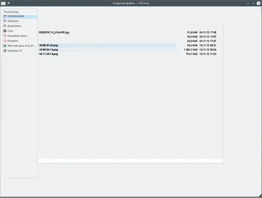

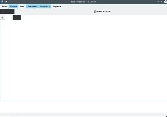

I'm using Kubuntu 15.10 with Plasma 5 about 2 weeks.
It has been a few updates, but the problem is still, and it prevent to work normaly.

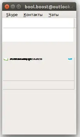

I don't know what problem is it, but this happens only with Qt apps.
So if i run open dialog from Firefox (which used GTK window?) or open Transmission app, they work normaly.
I tried check and uncheck of 'Processor microcode firmware for Intel CPUs'. Disable animation (ALT+SHIFT+F12). Select OpenGL render 3.1, 2.0, and so on.
I also tried diffirent version of drivers, currently i have Nvidia 352.41 (nvidia-352-update).

Upd 17.11.15
This problem is also represented on Ubuntu 14.04.2 LTS.
Qt:5.2.1 on this ubuntu PC. So problem is more global then just KDE and Plasma.

So yes, native render for Qt is solution of this problem. Steps i'm doing to fixing:
  1. sudo nano /etc/environment
  2. Add new line to the bottom of the file (second line for me) with this QT_GRAPHICSSYSTEM=native
  3. Save and exit by pressing: CTRL+O, CTRL+X
  4. Reboot the system: sudo shutdown -r
Thats it.
