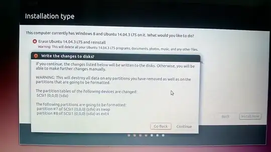

I am trying to install a fresh version of Ubuntu in my computer without touching the windows 10 dual boot!
In the Installation Type, the first option seems exactly what i wanted to do.
My question is, is this feature is safe to use? because i don't want to lose any windows files and other NTFS partitions on the hard-disk. Please eliminate my confusion.
Note as that i dont need any files or media which are in the ubuntu partition, Thanks.

It's saying that the partition that you have created as logical, i.e,
/dev/sda7 which is of type swap and
the partition /dev/sda8 of type ext4
will be formatted and made clean to make space for the new installation of Ubuntu OS.

  • 8,135
Can confirm, used the first option of "Erase Ubuntu 16.04 and Reinstall". Afterwards my partition with Ubuntu was formatted and the Windows 10 partition was untouched.
