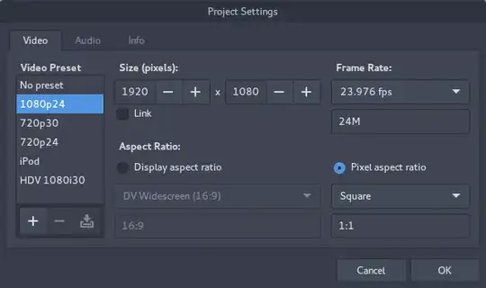

You probably just need to adjust two bunch of settings - the project settings: enter image description here

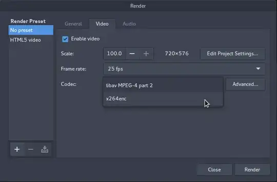

and the render settings: enter image description here
(With both check the audio settings as well, and when rendering select the appropriate output format and codec, then you could try the advanced settings')
Bear in mind if you make it to high quality many devices may have difficulty playing/rendering it - though rendering a HD version and using ffmpeg to make lower quality versions could work well. Also if you do test renders with smaller chunks of video means you can tweak the settings until you get the result you want, and then you can save a preset so you can use those settings later.
