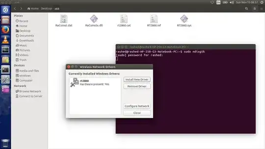

I use a RT3290 Wireless 802.11n 1T/1R PCIe wifi card. This card does not has a proper driver for ubuntu, I tried several post but I had no luck. Now I've tried to install windows driver for the card using Windows Wireless Drivers, and I have attached the picture.
Here the driver installed properly. But after installation the driver is not recognized by the Ubuntu. Here is the output of sudo lshw -C network
