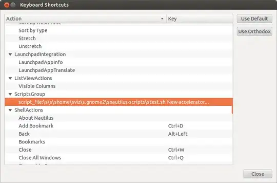

This Nautilus extension allows you to edit keyboard shortcuts (accelerators).
After installing the extensions go to Edit -> Keyboard Shortcuts... in the main menu and navigate to ScriptsGroup in the Keyboard Shortcuts dialog. Click the Key cell corresponding to the script you need and enter a shortcut: enter image description here
Unlike the can_change_accels solution this will also work with Unity's global menus.
