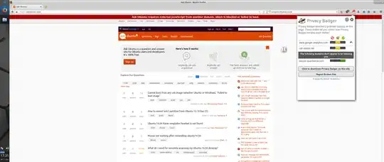

I am experiencing problems with the shadow display of the Compton composite manager. In certain situations, the frame for the shadows exceeds the window it is applied to, leaving a visible border and sort of a transparent box around it.
This seems to occur every time a window or frame overlay is not perfectly rectangular, such as the automatic scroll pointer in Firefox or the addon-menus with little arrowheads on top (please see the screenshot below for reference). There are a few other occasions like these outside my web browser, but I am not able to remember anything in particular at the moment.

If you are talking about Privacy Badger shadow, then this problem could be solved by adding following line to your shadow-exclude list:
"class_g = 'Firefox' && argb"
It will remove shadow from such windows, but leave it on menu (if not disabled) and main window. Source is here & here. There're some explanation about the issue.
