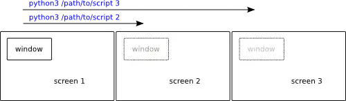

Moving windows across multiple screens, using the screen as an argument
Below a script to make available under three (for three screens) shortcut keys. By pressing the keys, you can move the windows to either screen 1, 2 or 3. The script calculates on what screen the window is on, and the distance the window has to be moved.

How to use
  1. The script needs wmctrl:
    sudo apt-get install wmctrl
  2. Copy the script into an empty file, save it as move_window.py
  3. Test- run the script by running it in a terminal window, with the commands:
    python3 /path/to/move_window.py 1
    To move the active window to screen 1,
    python3 /path/to/move_window.py 2
    To move the active window to screen 2,
    python3 /path/to/move_window.py 3
    To move the active window to screen 3
    Since the terminal is your active window, it should move across your screens on the commands.
