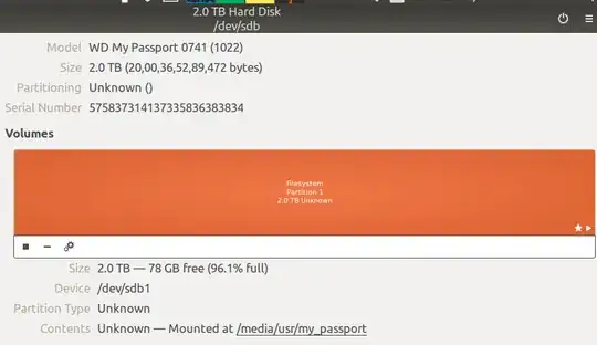

  1. Here is how it shows up on the Disks application
    screenshot of Disks

    • Created a directory /media/usr/external/ and ran sudo mount -t ntfs-3g /dev/sdb1 /media/usr/external. HDD mounted perfectly.
    • Disks application now recognizes the mounted HDD Disks application now recognizes the mounted HDD

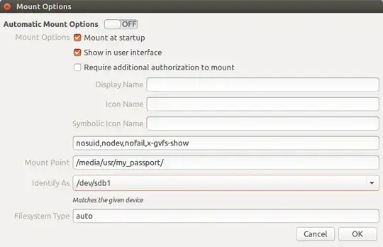

    • I tried to change the Mount options to make it similar to my internal HDD (turning Automatic Mount Options ON did not help). The Mount at Startup option made no difference when checked. mount options This is what my fstab looks like now (removed swap entry)

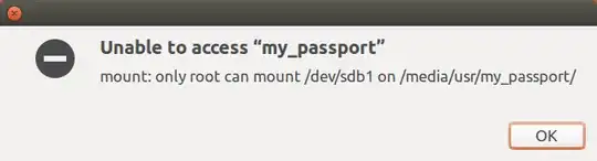

    • After disconnecting and reconnecting the HDD - it does not automount. Trying to mount from Nautilus gives me the following error. Only root can mount
How do I go about automounting my HDD, now that the mounting problems have been solved? Earlier I never had to sudo for mounting - it just connected.
