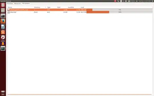

I seem to have plenty of space on boot. I have whole disk encryption.
First:

Picture of System Monitor showing disk Space:
System Monitor Showing Disk Space
