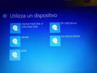

I did found a way to boot into Ubuntu through the GRUB. Holding down F11 during the booting process, Windows will boot into the blue "safe mode". In there if you select the "chose a booting device" option you will have the choice to boot from a series of devices, including GRUB and Ubuntu (which however both result in booting from the GRUB). Here is a photo of this menu (sorry for the non-english language, the title says "Use a device"):
While this method works, it is obviously a pain to have to do this procedure every time, but this proves that grub is installed correctly. "Only" the boot loader priority seems to be messed up. How can I force the boot loader to boot into GRUB instead of windows?

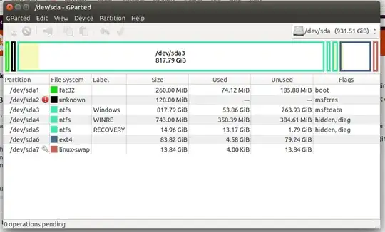

  2. Here is a snapshot of the partition table given by gparted: enter image description here

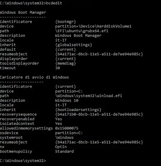

  3. Here is the output of bcdedit on Windows 10:
glS

Tried this command in your windows cmd (as administrator)
bcdedit /set {bootmgr} path \EFI\ubuntu\grubx64.efi
If that not works, try this
bcdedit /set {bootmgr} path \EFI\ubuntu\bootx64.efi
