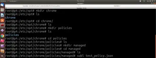

first_image
second_image
sudo -i
cd ../
ls
cd etc/opt
mkdir chrome
ls
cd chrome
ls
mkdir policies
ls
cd policies
ls
mkdir managed
ls
cd managed
ls
subl test_policy.json
subl is an alias for sublime text. If you have not installed sublime text and set up this alias, instead of subl, one can use
touch test_policy.json
xdg-open test_policy.json
This will create and open the test_policy.json in your default editor.
