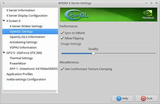

I have tried those solutions and i am still getting terrible image tearing on the screen while scrolling though a web page. enter image description here
I have enabled Sync to VBlack and Allow Flipping in nvidia settings and added compton -b to start up.

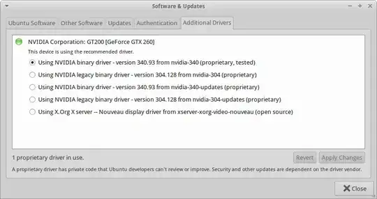

Driver in use. enter image description here
