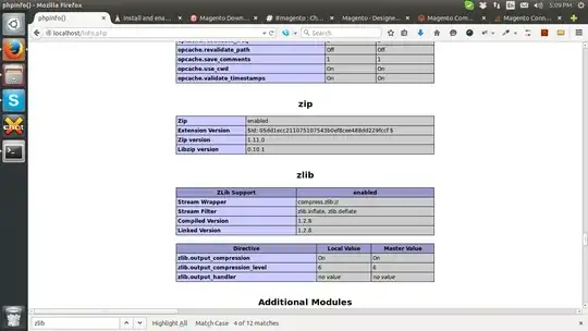

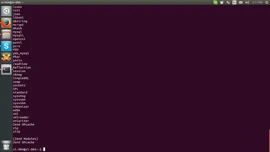

zlib is insalled in My Ubuntu enter image description here
Also enabled and loaded in PHP ini enter image description here
