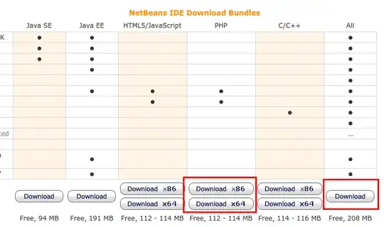

As a workaround, it appears that the full netbeans download works. This type of netbeans installation only has one download option rather than 1 for x86 and 1 for x64. I wonder if it is related to that or just the PHP version has a bug?
For now, I'm going to leave it at that and use the full version, but I would be keen to see if there is an actual solution for those of us who just want the minimal PHP installation.
