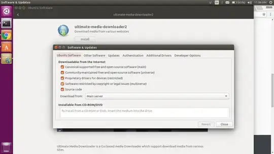

I also face the same problem. To overcome it, you need to change the server to the main server.
Just go to Software & Updates and change the server to the main server next to Download from.
Software & Updates dialog - Download from: main server
First time after Ubuntu installation you may not be able to find Main server option. Then follow this - Download from -> other... -> Select Best Server -> Choose Server. This will select the optimum server and might take some time. Afterwards sudo apt-get update && sudo apt-get upgrade. If you go and check Download from now onwards you will find Main server in the available list.
