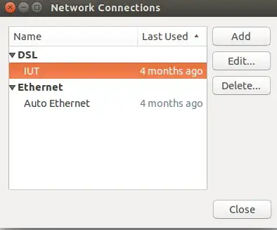

if I go to "edit connection" I see my dsl connection but there is no connection showed in network indicator.
So I can't connect to my dsl connection from my network indicator.

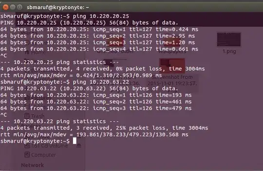

The worst part is, there is a ftp server in my university. But I can't access it. Even I can't access any other ip who share their folders in the network. here is a image that my ftp(10.220.20.25) and other PC in the lan network (example 10.220.63.22) got successfully pinged. See the image,
and also I can't find any PC in the ShareScanner. Sometimes I got 2-3 PC in my network but don't find the all PC's though ping shows they are online.
