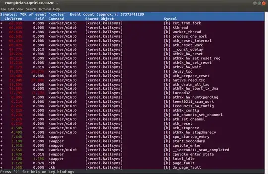

I've tried running echo l > /proc/sysrq-trigger but I get no ouput, and when I run perf record -g -a sleep 10 with perf report I get the following screen, but I'm not entirely sure about what I'm looking at.
screenshot
Do uname -r to check your kernel version, if it is before 2.6.30, I recommend upgrading it, which should fix any issues with that driver set.
  1. Go here: http://kernel.ubuntu.com/~kernel-ppa/mainline/ and pick a kernel to upgrade to. [http://kernel.ubuntu.com/~kernel-ppa/mainline/v3.18.12-vivid/ is known working with most adapters in the 9k models]
  2. Download 3 (maybe 4) debs to a folder somewhere:
    linux-headers-VERSION-NUMBER_all.deb
    linux-headers-VERSION-NUMBER_amd64.deb
    linux-image-VERSION-NUMBER_amd64.deb
    linux-image-extra-VERSION-NUMBER_amd64.deb   # if applicable
  3. Install the debs with whatever package manager front-end you use, or use these commands: cd /path/to/folder/where/you/put/the/debs sudo dpkg -i *.deb
If you're not interested in a kernel upgrade (you should be) or if it doesn't fix the issue as it presents, try installing backports meant to fix issues with the atheros 9k.
http://apt.ubuntu.com/p/linux-backports-modules-wireless-tahr-generic
The answer to this method can be found here, though I don't recommend hacking together what can be fixed with a simple kernel upgrade: How do I get the ath9k driver of backports-3.12-8 installed on Xubuntu 13.10?
