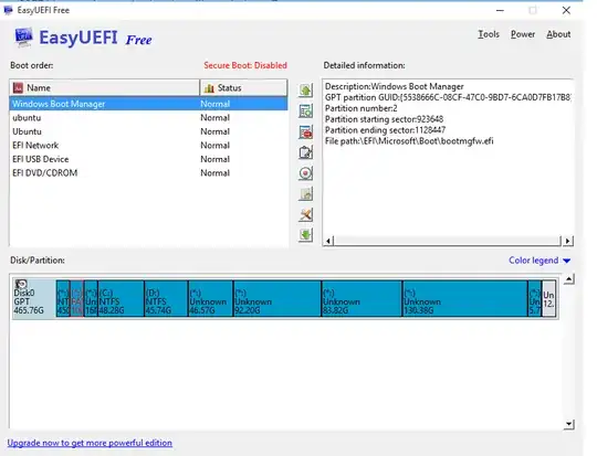

I just installed easyuefi as suggested by 金潇泽. Here it a screenshot:
How can I use it?

It seems everything is OK judging from your screenshot.The only thing you should do is to change the position of ubuntu to the top and reboot.
