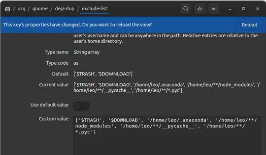

  1. install dconf-editor
sudo apt install dconf-editor
  1. run dconf-editor as normal user. (don't use sudo)
dconf-editor
  1. locate org -> gnome -> deja-dup -> exclude-list
  2. set Custom value to (replace leo with your user name)
['$TRASH', '$DOWNLOAD', '/home/leo/.anaconda', '/home/leo/**/node_modules', '/home/leo/**/__pycache__', '/home/leo/**/*.pyc']
  1. You might need to reboot/re-signin. I run Screenshot which automatically update the value. I don't know why, maybe someone else can explain.
Screenshots:
Replace leo with your user name
replace 'leo' with your user name
It should look like this way
